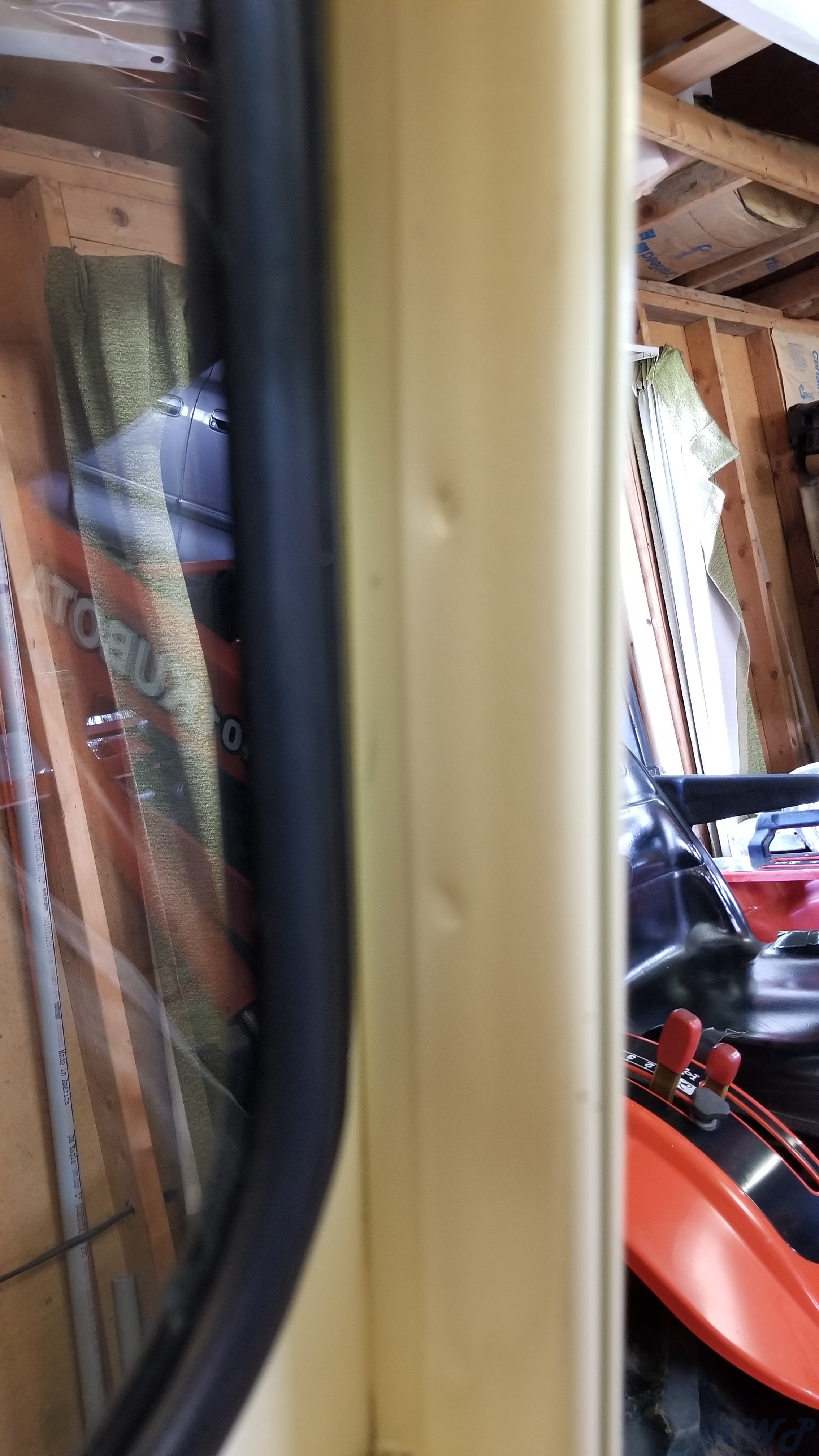

Here are a couple I took when repairing my windshield frame.
I have others that I'll post when I figure out where Windows 10 hid them.........

Dave,
As mentioned, regardless of screws or welding, you can weld/grind and make it look original.
I took a peek at Walck's and noticed no image also.  It mentioned it includes the upper hinge for the door - which should be correct.  I noticed the same channels at another vendor with images and they seem to be the same.

« Reply #4 on: June 04, 2018, 06:44:49 PM »
Here is another pic showing the upper door hinge and channel.
Those in the link in the above post look correct....
That hole in front of the top frame iron is for the hard top...
« Last Edit: June 04, 2018, 06:45:44 PM by 1955CJ-5 »
Re: Orig. soft top door channel on windshield?
« Reply #5 on: June 04, 2018, 07:14:18 PM »
After viewing Randy's photos, I'm way off base.  The side channels are simply spot welded.  The horizontal channel shown in the photo is held in place with these small uniform deep welds.  Clearly a different process.

Here is a good comparison with Tim's photo...
My frame had all these little holes for the hard top.
The only other holes are for the rear view mirror, wipers, center vent hinge bolts and latches.
At just the right speed the little holes whistle..jeep music!
« Last Edit: June 04, 2018, 07:37:22 PM by 1955CJ-5 »
