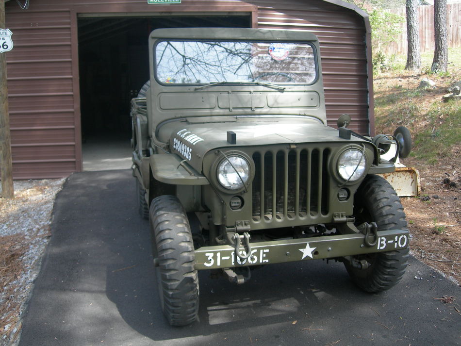

Thanks for the replies. I have posted on a local face book group that specialises in military vehicles in New Zealand encase it was a special order  (.e.g. with an artic top) as per: http://davidsclassiccars.com/willys/270723-willys-m38-jeep-rare-arctic-package-korean-war-body-off-frame-restoration.html.
Re: CJ3A / M38 Windscreen
« Reply #6 on: August 24, 2021, 04:09:26 PM »
All the M38's with the artic top kits that I have seen use a windshield frame with no pivot points. The windshield frame mounts vertical and bolts to the side of the body. I can't tell from your photo, but does your windshield frame have pivot arms?
« Reply #8 on: August 25, 2021, 08:46:04 AM »
My vote is reproduction. The two piece exterior sheet metal leads me to think that.
« Reply #9 on: August 25, 2021, 11:59:16 PM »
Good eye! I didn't catch that! My M38 windshield sheet-metal is a single piece, I think you are exactly right.
