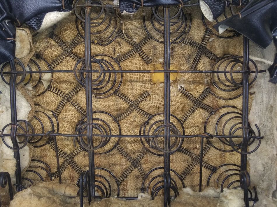

I bought one set of seat bottom springs from Matt, it was complete except for the small springs between the coils, but very rusty. I just used it for parts to replace two broken coil springs in my original seat.

My CJ-5 still has the original seat springs. The driver side is getting a little soft as you might expect.
Using the ebay springs for replacement parts is a good idea.
Do you have a source for the small tension springs that are arranged in an "X" between the coils? I found that tightening those helped firm up the seat a bit, but they are tired too....

My tension springs were in good shape, so I reused them. Looks like McMaster-Carr has 36" lengths of extension spring stock in all diameters that would probably work in this application.
https://www.mcmaster.com/springs/extension-spring-stock-6/
My M38 has foam blocks from WeeBee which don't give very much. The original springs in my 1964 CJ3B seats are very comfortable, much more so than the M38 seats.
Mice got into my seats and started pulling the cotton batting out and also looks like the burlap is getting a little rotten, so at some point, I am going to try to remove the original vinyl covers and replace the stuffing.
