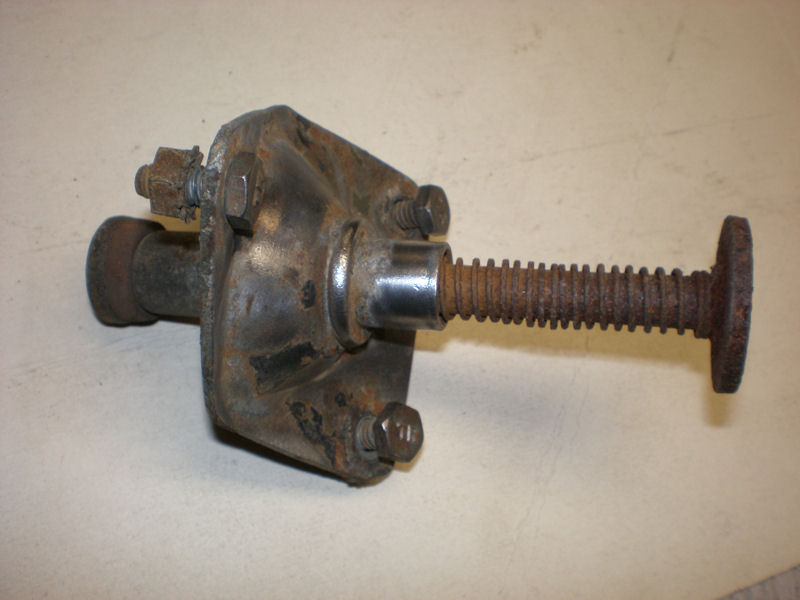

Gents,
Easy question here, the original Willys foot starter used a block of Oak to center the push rod and support it in the cab, it was bolted to the fire wall, the rod went through it and connected to the starter.  At least that is how I understand it.
1, Does anybody know the thickness of that block?  It seems that anything over about 1/4 inch thick will be difficult to thread onto the push rod, at least I'm assuming that you have to have a hole no larger than 3/8 inch in order to properly center the push rod.
2, The other option is to cut the round push plate off, thread the rod through the block and re-weld the push plate back on.  Seems odd to do it that way.
What say you all?

I made my own plate out of 1/8 inch steel and then a 1/4  inch thick piece of rubber with a smaller hole for the push petal rod. No rattles that way and works like the wood. Very stupid design. The floor 2A button in my opinion worked so much better. They went backwards on this one. John

I made a out of oak following the specs on Bob W's page. So far so good:
http://www.cj3a.info/tech/sblock.html

I also made one using Bob's dimensions...I used 1/4" birch aircraft plywood,mostly because I already had some... and then  I painted it.
Most hobby stores that carry model airplanes would have it...

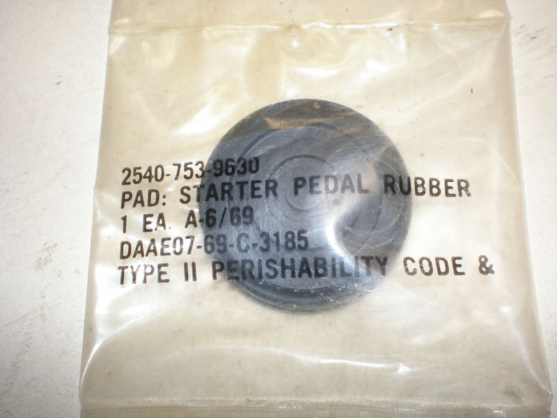

And both the M-38 and utility vehicles had a rubber pad on the starter pedal.
Re: Foot Starter
« Reply #9 on: April 08, 2014, 08:47:55 PM »
I used one of those pads on my 3a....it helps keep your foot in place...they will also work on the horn button!
