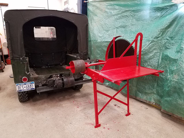

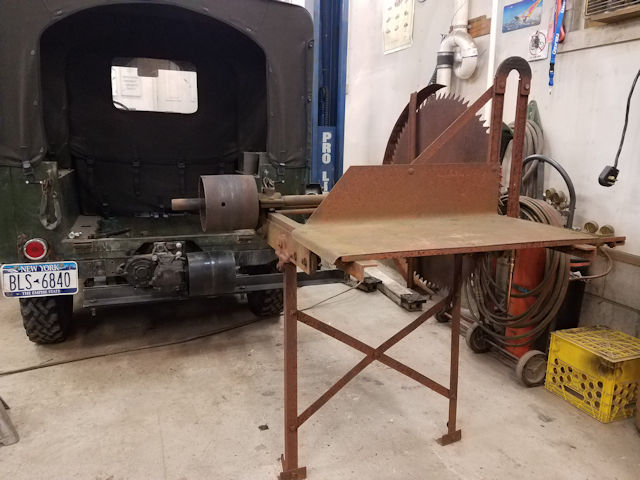

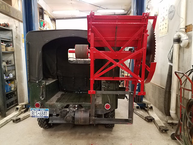

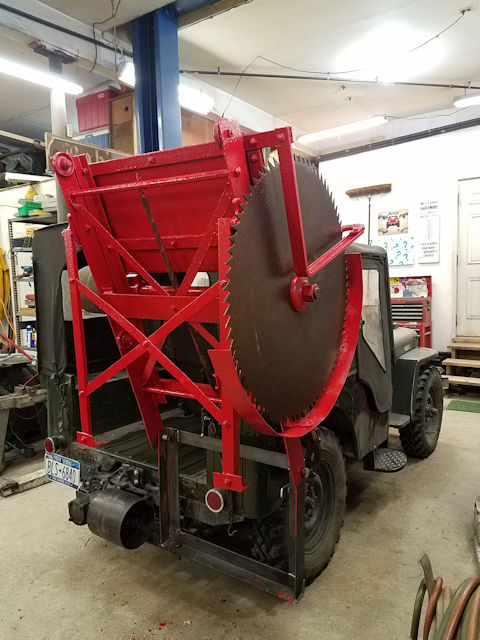

I finished up fabricating the unique parts that attach the saw to the Jeep.
It's not really as practical as the advertisement suggests. A lot of these early Jeep attachments didn't work out like advertised. "Quick on - Quick off" not so much. "Fully Portable" = maybe portable. Here are some photos...
